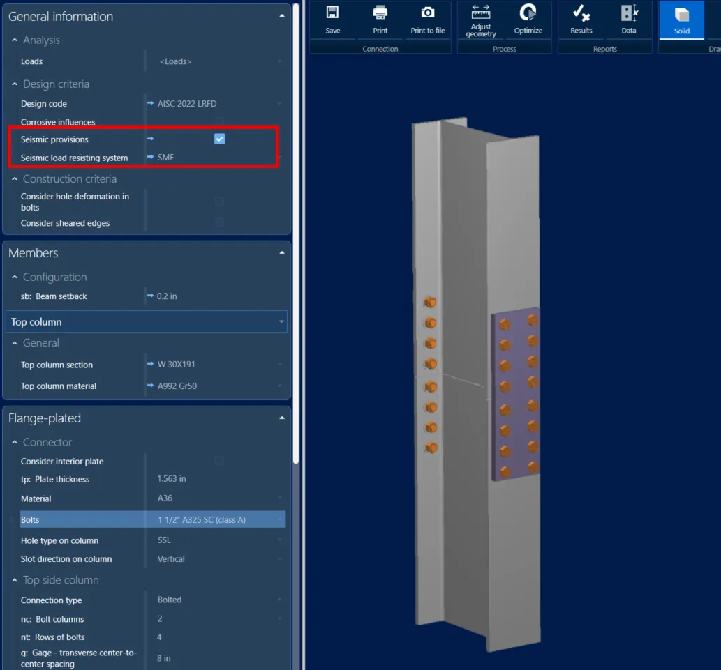

3. Column Splice Flange Plate Connection with AISC 341 Seismic Provisions. This release introduces enhanced Column Splice Flange Plate Connections that incorporate the seismic design provisions of AISC 341, expanding the program's capabilities for designing lateral force-resisting systems in high seismic regions. The new implementation integrates the specific detailing and strength requirements defined in AISC 341, Chapter D2, ensuring that splice designs meet the stringent ductility and overstrength criteria necessary for seismic performance.
Close
Figure 5. Seismic provisions options for the Column Splice Flange Plate connection in AISC.
