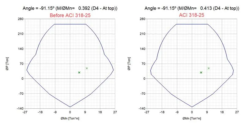

ACI 318-25 refines several strength provisions to improve design consistency. The shear strength equations were revised to restore capacity in members affected by size-effect reductions in ACI 318-19, particularly for walls and footings. Seismic wall provisions were adjusted to reduce excessive conservatism in high-ductility designs. Updates to development length and φ-factors improve anchorage predictions. Notably, the φ-factor for flexural compression now varies with axial load, producing smoother and more realistic P-M interaction curves near balanced point for columns and compression-controlled members.
Close
Figure 3. Changes in the flexural compression zone in the P-M interaction curve

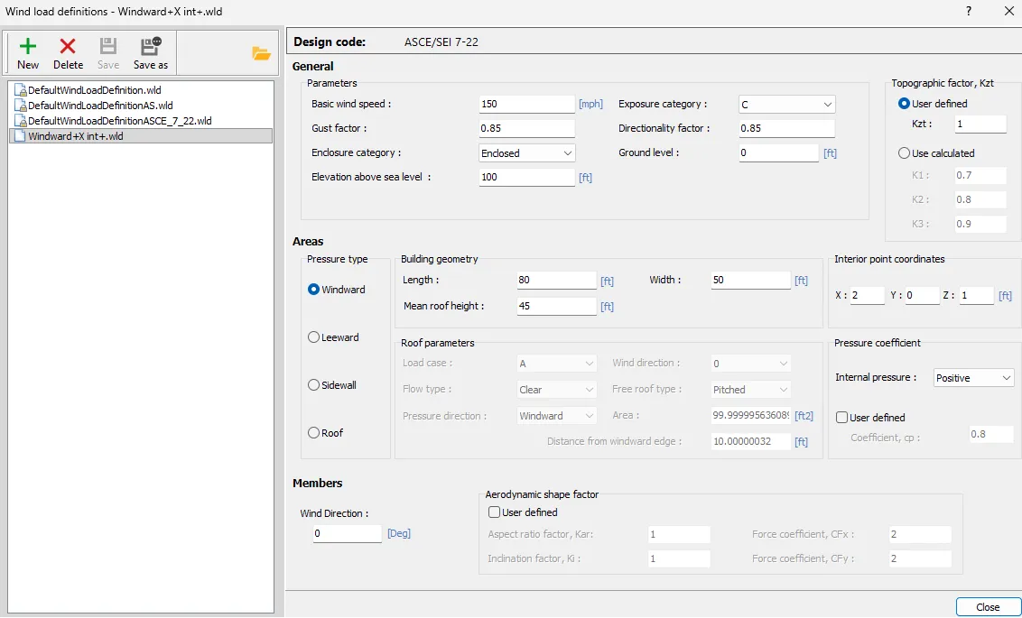

3. ASCE 7-22 Wind Load Definitions Generator. This release introduces an enhanced Wind Load Generator that now supports ASCE 7-22 definitions for wind loads. The Wind Load Definition dialog has been updated to allow users to select among different ASCE standards (ASCE 7-16, and ASCE 7-22), providing greater flexibility when defining parameters.
Close
Figure 7. New ASCE 7-22 wind load definition

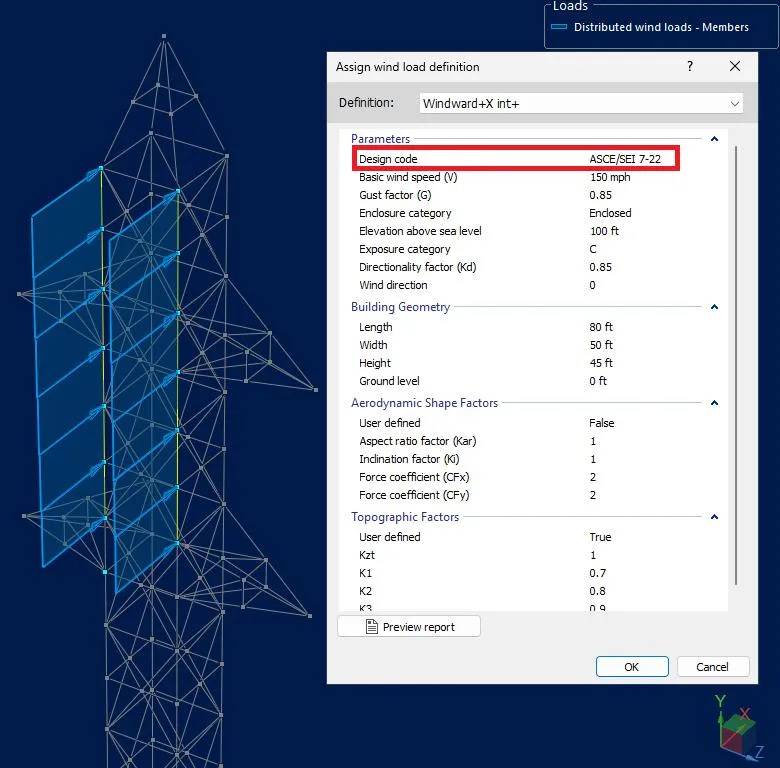

The implementation includes all required updates to generate wind loads on both areas and members incorporating revised pressure coefficients, exposure categories, etc. consistent with the ASCE 7-22 standard.
Close
Figure 8. New ASCE 7-22 wind load generated over members.

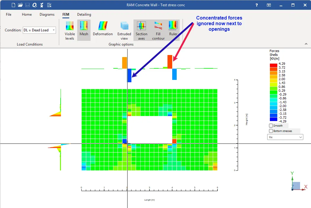

4. Wall Modules Distribution of Stress at Openings Enhancement. Following improvements to the force integration routine in the wall modules, certain models were exhibiting higher stress ratios near discontinuities such as openings. These peaks are caused by stress singularities that occur at sharp geometry transitions and are now more accurately captured by the refined integration scheme.
Close
Figure 9. Concentrated forces near openings
To address this, the extreme FEM elements around openings are now intentionally skipped during the evaluation of out-of-plane shear. These edge elements often experience localized stiffness and mesh effects that do not represent the actual structural behavior. By excluding them, the results provide a smoother and more realistic shear distribution across the wall panel, minimizing noise and eliminating artificial stress concentrations near opening boundaries. The technique aligns with classic findings in computational mechanics on stress concentration (e.g. see Xie et al.)
Close
Figure 10. Concentrated forces near openings fixed to prevent unreal higher stresses
This approach ensures that the reported forces better reflect the global behavior of the wall, while maintaining the improved numerical precision introduced by the updated integration method.

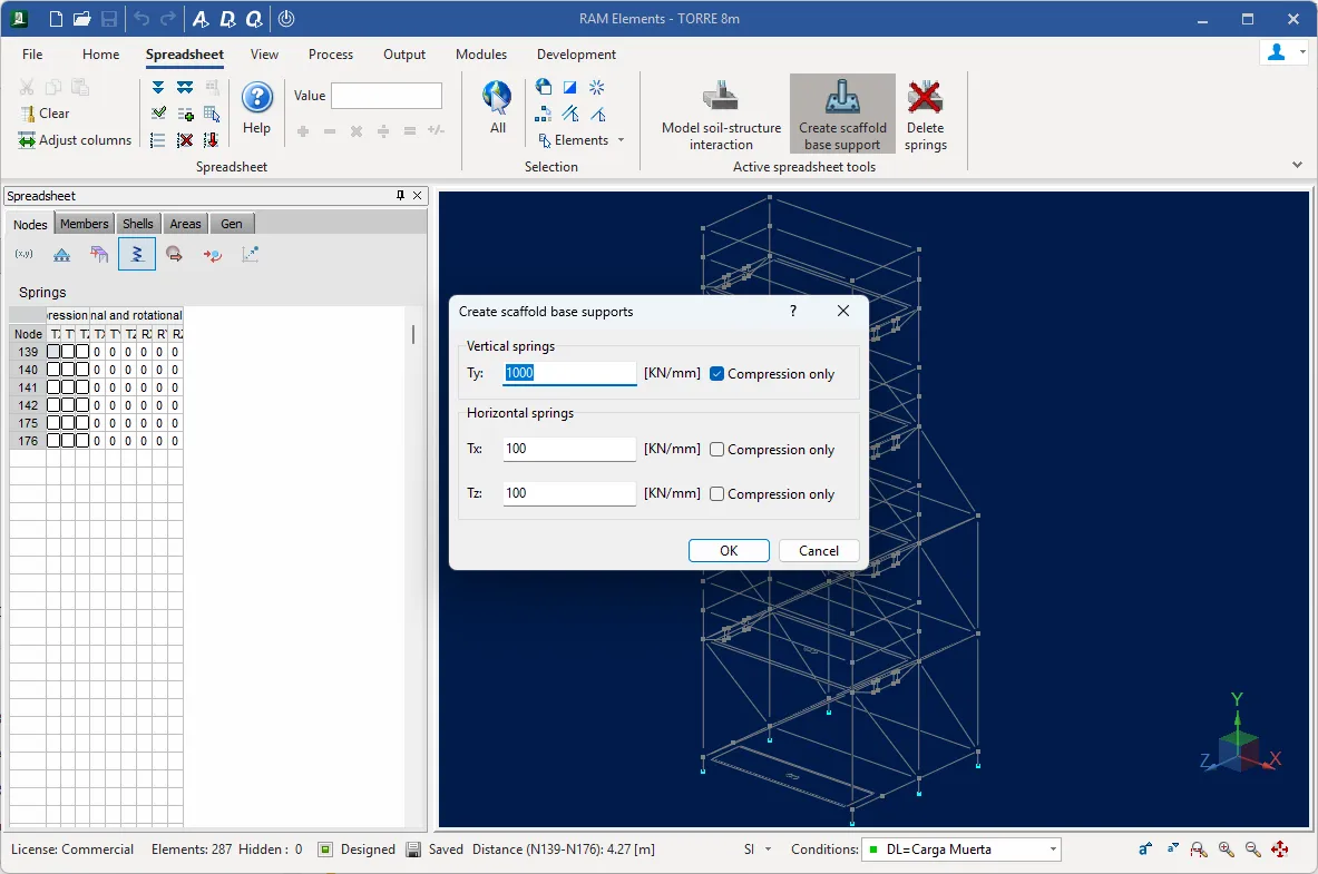

5. New Scaffold Base Support Tool:A new tool has been added for the analysis of temporary scaffolding structures. Scaffoldings are temporary systems supported directly on the floor. The new feature allows users to model this behavior accurately by defining compression-only base supports. This approach prevents unrealistic uplift reactions and provides a more realistic distribution of vertical forces under gravity and lateral loads.
Close
Figure 11. New scaffold base supports tool to define base supports.
